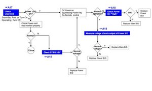

Here is the flowchart for your model.
You do have the 3.5V on standby. Check fuse F2 for continuity and you do see the voltages to the right of the transformer. you couild measure to see if those are existant on the bottom of the board. The part where the clicking comes from, appears to contain at least one diode as well as a power transistor. You could check on those parts. For now, if everything checks out and your board does not have the 13.2Voltage that would mean that this is a bad power board. (beyond bad capacitors)

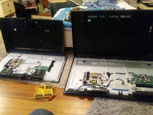

this is what I got apart so far. One on the left 43in works fine. Just busted the screen. Kid hit it playing in the house. Other just stopped working 2 days ago.
