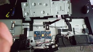

I have a sony bravia kdl-40w605b.
There is no picture but the sound works fine at least I can hear the beeps from the menu even though I cannot see it.
The backlight is working fine.
This would normally be put down to a t-con failure however there appears to be no dedicated t-con board. The t-con cable goes directly from the mainboard to the screen.
I have replaced both the mainboard and t-con cable with no joy.
Is there something I am missing? Could this be the power board or something else?

So new power board caused 6 red blinks so I'm guessing that I either got sold a duff board or it's the wrong board despite having the same model number.
Im including a picture of the boards now.

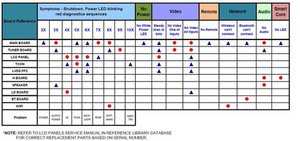

@thelazydj I would have measured the output from the power supply to the mainboard first. Remember that it is your main board that turns on the power supply etc. since you already replaced the main board and the cable, you only have the power supply left. Here is the Sony triage sheet for your TV model
It shows which boards are common failure based on your TV’s symptoms. You said you replaced the main board but did not tell us if your replacement included the tuner board. Sony part number A-1998-231-A. Post some images of the boards you replaced. Use this guide for that Adding images to an existing question

I have updated and included a picture of the boards.
If the board attatched to the mainboard is the tuner board then I have not replaced that one yet.
I have sound fine through all sources, backlight is fine. Mainboard and t-con cable are fine. Power board is inconclusive (read update). So really just the tuner board to check as there is no t-con board in this set.
Admittedly I am somewhat an amateur an this is only my 4th fix but I am completley stumped. I'm starting to think the panel may be dead as nothing else appears to be working.
@thelazydj usre the panel is always a possibility but your TV's symptoms would be atypical for that. "If the board attatched to the mainboard is the tuner board " yes it is. That is definitely a board that can cause your TV's issues.
Just read about the 6 blinks and as you can see on the Sony triage this could be a mainboard issue or a panel issue. Double check the board and do not rule out the tuner board yet. It is directly connected to the main board and could cause teh main board to either fail or just not getting signal etc.
The board on the left hand side of the picture is called the LD HM board and may be the problem board here. It is part number: A-2194-269-A. I would try that one.
