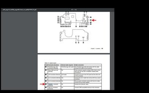

Hi @reverendalc ,
According to this image taken from the service manual for your laptop, the connector that you are referring to, is the OneLink+ dock connector. Is this the one that you mean?
If it is the one, then it shows that it is mounted directly onto the systemboard and is not on a separate board.
(click on image to enlarge for better viewing)
You are correct, that is the configuration of this laptop! I was having great difficulty finding any docs for this laptop. As it stands now, it just bricked itself doing a firmware update. You wouldn’t happen to have a clean bios file?

Hi @reverendalc ,
You may have to contact Lenovo regarding getting a replacement connector with the correct configuration as searching online reveals no info regarding the motherboard's OneLink+ dock connector.
Also regarding the BIOS file you may be out of luck as according to the Read Me file attached to the latest BIOS update file (V1.55) taken from this webpage, it states that if the update process is interrupted the systemboard may have to be replaced. Unfortunately it doesn't state how to recover from a failed BIOS update.
It does mention that you cannot roll back to versions before V1.50 in case you do happen to find a pre V1.50 version BIOS file.

well my dock connector is fine, it's simply the adjacent USB socket which is damaged. i've already (much to my chagrin) purchased the BIOS file, and i'll write it with my SPI programmer manually. that's of no real consequence other than inconvenience... and the few dollars the bios dump cost me. i'm preparing to open it up tonight. if push comes to shove, i suppose i'll just remove the USB jack and see if i can find a comparable unit on arrow or mouser
i have restored the BIOS to the laptop, and it's functioning again. i've uploaded some pictures of the port.
Hi @reverendalc ,
You're right. It appears to be a fairly standard type of USB connector. Mouser should be able to help with the correct one.
