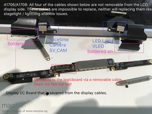

The signaling is a raw display signal unlike what we've seen in the past. Before we had LVDS, then iDP (also known as eDP) which is what the older retina displays used. Here the signal is not converted as the T-CON board is mounted at the hinge area just above the main logic board.
Here’s an image of the display connections for all of the newer 13” & 15” TB & Fn models.
The signal cabled or soldered to the T-CON and not replaceable or removable without damage.
Sadly, nothing here to fix.
So, in other words, I just have to change the entire display unit
Sadly, yes. I'm sorry Apple did us in making these system harder to service.

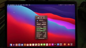

Hello guys, I have MacBook PRO 2016 late Touch Bar 15 inch, few days back after working through when I turned it off. Next morning as I opened the lid I found one green vertical bar, which shows whole screen flickering when I place my cursor on it ( green vertical bar) as I took a screenshot of it to check whether it was a software issue or hardware since the bar doesn’t appear on the screenshot. it’s so annoying. I bought this device in 2017 feb. no idea what to do, please HELP
Update (11/19/2020)
Update (11/19/2020)
Update (11/19/2020)
On white background it would go enormous
no idea what’s happening. Never dropped or any bang ever.
