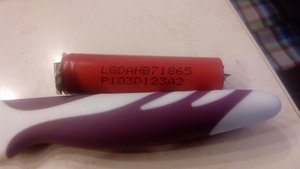

Thanks everyone for your feedback! Replacing the batteries solved the problem in my case.
Original batteries weren’t available when I was searching. I managed to swap the batteries with the “SAMSUNG-30Q-18650-3000-FLAT“. So far everything works perfectly.

Hi, I used the same model battery SAMSUNG-30Q-18650-3000-FLAT (with solder tabs) but only replaced the one offending cell that was failing. You can determine this by measuring the temperature of the batteries during the 30 second running of the motor. Just as the motor would stop one of the cells was reaching a temp > 110 DegF using IR, while the others were ~ 90. Cut and replaced that cell and working well now.

Unit uses 5x LG HB7 18650 1500mAh 15A Battery "LGDAHB71865 - P091C313A1". I can't seam to find these exact batteries to replace, any idea of a great alternative and/or were to buy them? Thanks
you can find those @ IMR batteries .
It`s normal that after 2 years of charging/recharing , bateries lost it`s performance. But it`s no problem to exchange beteries. In this vacum model you need to buy any Li-Ion 18650 bateries (5 pieces for 18V model) . You need to remember only, to buy orginal bateries: (LG, Panasonic, Samsung etc). LG are dedicated for this modl but can be any other Lithium !! Capacity between 2500 - 3500 mAh Vacum has biulded BMS module only for this king of bateries. Exchange is very simple for each person who have basic knowledge about electronics or buildings RC battery package.
