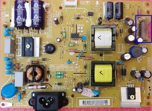

I had the same problem on an LG 32LB5610. The brightness levels/backlight were uniformly low 95% of the time, with some flickering, only occasionally and for a few seconds. Most of the time it was just very dark.
I tried a new power supply board, as thought the backlights weren't getting enough power, but the problems were identical with the new board. I couldn't face taking it apart to change the backlight so sacked it off!

once you remove the back from your TV, turn it on and check if you can see the backlight on. Inspection holes can be used as shown
If no backlight is visible start by measuring the connector on th epower board and see if it shows 24V on it.
Post some images of all of your boards with your question. That way we can see what you see. Use this guide Adding images to an existing question for that

FYI I had the same problem as he did. Sporadic dim screen not affected by any settings changes, uniform to all inputs. I checked my voltage as the other user suggested and sure enough, wasn’t getting enough out it to the LEDs. Bought a new power supply board and problem fixed!

I would suspect that the back light is not working correctly. If the picture is there and uniformly dim, I would suspect that there is a problem with the power supply. The LEDs that provide the back light may not be fully energized. If that is the case, the power supply is faulty. If you can, post a picture of the boards inside the unit by taking off the back. That will help to confirm our suspicions.

I again believe that the back light is working, just not up to full brightness. A fault in the power supply that does not provide the full voltage required for full brightness is the likely cause here. Most back lights are a series of LED strips with the LEDs in series. Each LED requires 3.3V for full brightness. As an example, 10 LEDs in series will require 33V to be fully powered. Lower voltage than the 33V may allow the LEDs to light, but at a lower output thus a dim picture. Look at the power supply and post a picture if you can.
