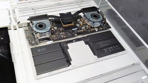

I was trying to find one as well, however nobody on the whole Internet seem to have done this. These are all I can find, from Microsoft showcase events. Source link: https://hothardware.com/reviews/microsof...
GTX 1060 base board with heatsink and dual fan, with battery bottom plate.
Upper system board with heatsink, the interesting part is that the system was designed with 2 fans, later it was determined that one would suffice. Note that the fan and board are upside down. Actual layout is electronics face away from the screen and the fan is at the left. The flat plate heat spreader with ram horn style heatsink is interesting. SSD is swappable, the rest is soldered onto the board.

i must admit, these are 2 very descriptive pictures. do you think the heat sink is aluminium or copper/nickel plated? im tempted to use liquid metal but risk is currently outweighing the gain, without knowledge of the heatsink's material
Risk definitely outweighs gain. You risk cracking the screen, ruining the antennas, the screen tend to fall off after reassembly because you can't find the right adhesive set to replace. Also the cooling is mostly adequate anyway. Based on the coloring, the heatsink seems to be bare cooper.

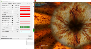

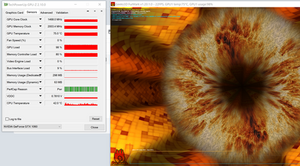

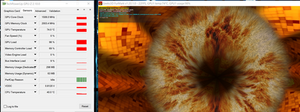

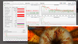

Actually from my usage I felt the base cooling is mostly adequate. The bottleneck here is power supply and in some occasions, PCIe 3.0 x4 connection.
can you use furmark for me at best performance, plugged in and see how far down the gpu throttles after 15-20min?
i never tested it before applying liquid metal :p
like what mhz does the gpu clock stablize at with stock paste @tomchai
I wasn't able to get to thermal cap, cap reason were either idle or power, what resolution and AA setting are you using for Furmark? What is your room temperature?
My setting is 1080P, 8X AA, battery 90% charged, plugged in wall socket and set to best performance. GPU starts at 1500-1400, slowly drops to 1300-1200, don't see further drops but no thermal capping either.
