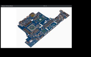

Would it possible for me to up grade my Alienware 15 r3 motherboard from a i5 at 2.5 GHz and GTX 1060 to an i7 at 2.9 GHz and GTX 1070?
Update (07/31/2018)
I'm sorry if my question was confusing but I was talking about a motherboard swap. Not just a gpu or CPU replacement specifically.
Hi,
Short answer is No.
The cpu and gpu are hard mounted onto the systemboard. You’d have to replace the systemboard.
Here’s a link to the service manual
Here’s an image taken from the service manual that shows the cpu and gpu on the systemboard after the removal of the heatsink.
(click on image to enlarge for better viewing)
