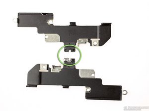

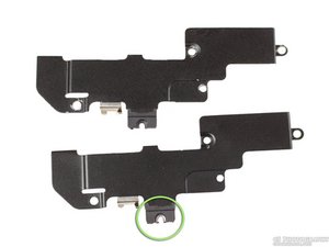

Losing the metal clips that you're talking of (marked in green on the bottom photos) is the top reason for abnormal Wi-Fi operation after reassembly.
Here are two images, which I shot, that better depict the cause of the issue. Once you lose that piece, you have no option but to order a replacement cover.
In case the images don't work here, here's an external link.

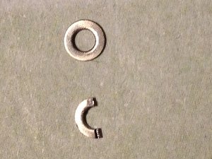

If you cannot wait for a new cover here is a
LOWPRICEFIX :)

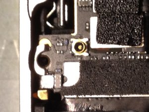

Just cut a washer from the iphone 4 screw kit in the middle and place as you can see on the photo on top the logic board, install the wifi cover than carefully screw the long screw tight so that it contacts with half the washer which contacts the golden pad of the logicboard.
uuuund scheissdiewandan wifi signal is back!!!!!

I had the same problem after replacing the screen on my iphone 4. I didn't even notice that I'd lost the little metal piece that fits around the long screw on the bottom of the wifi shield. I took the advice from Dave above and put a small square of tin foil on top of the logic board right where that log screw goes in (under the wifi shield). When the wifi shield is put back on, the long screw is driven through the tin foil which acts like the missing metal piece. Worked like a charm!
Just make sure the piece of tin foil is just big enough to fit in place of the missing metal part and does not touch the nearby connection points (the little metal dots) on the logic board below it. If you're not sure, check out the picture of the bottom of the shield that a couple people posted above.
