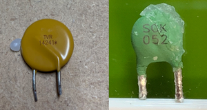

Another Play:1-owner gave me these, as you can see in the pictures:
TH301 (green thermistor): SCK 052
MOV301 (ocher metal oxide varistor): TVR 14241
The SCK 052 can be found on Ali Express.
The MOV301 in my device was a TVR 07431*, as shown by Ikke Zelluf.
This reference means 7 mm diameter, 431 voltage and D-type (high surge).
Can also be found on Ali Express, but as a regular type.
I had to order 20 pieces of each, for less than €6 in total. Delivery only after several weeks :-(
Finally, after replacing TH301 and MOV301, my Play:1 works well again, and stays much cooler at the back side.
