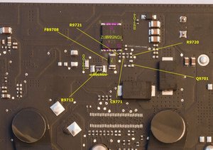

Edit 2018-07-06: Here is the logic board in pictures:
Edit 2018-07-13 : @oldturkey03 you asked me to check some voltages. So the fuse F9700 is ok and there is 12V. But there is 0V at the resistor R9704. The mosfet (FDMS6681Z, named Q9702 in the schema) seems fine:
  • Rgd = 112 kOhm
  • Rsg = 71 kOhm
  • Rsd = 36,3 kOhm (keeps increasing, capacitance effect?)
Here are the mosfet voltages:
  • Vg = 12V
  • Vs = 12V : is it normal?
  • Vd = 0V : should be 12V, right?
Here are the mosfet pins I measured, just to be sure:
I tried to look around for damaged stuff but I cannot find the schema components on the logic board: Q9701, R9720, R9721, C9771...
Also I found a component that seemed damaged to me, the one with a question mark and a red circle on the previous picture. Check this:
I thought it was a damaged capacitor but I only had a multimeter to test it. I unsoldered it and it looked like a 45 kOhm resistor, package 1206. It was a bit hard for me to solder it back. Maybe I overheated because at the end I measured 35 kOhm, but the iMac is still booting, phew.
You seem to know this circuit pretty well, do you know where I should check now, and do you know the name of the component I just abused lol?
Edit 2018-07-16 : Okay so with your corrections I remade a schema and took again voltages and resistances:
Can you confirm if I've written the right components?
The backlight was fine a few weeks ago, it stopped working suddenly and they gave me the computer without any human intervention.
I wonder if there is something wrong with R9720. Either it's a faulty contact between the circuit and my multimeter or the resistance is absent (?), dead or unsoldered. I cannot see because it's hidden on the other side of the board.
Edit 2018-07-17: R9720 is not assembled as specified in the schema ("NO STUFF" = do not stuff, do not assemble), so it's open circuit.
Edit 2018-07-18: I had to give back the iMac today... They'll go to an Apple store to get a repair estimate. I hope to know how it ends, for the sake of curiosity...

@merinorus I’d start of with some simple voltage testing. Check on R9704 and see if you have 12VDC there. Check on F9700 and ensure it has continuity and 12VDC on it.
Update (07/13/2018)
@merinorus that is FB9708. If you have 12V on the points you are showing but not turning on then you may have issues with eitehr Q9702 or with the backlight enable circuitry.
Update (07/13/2018)
it would be good to know if the backlight has worked before or if there was any work done on the board.
