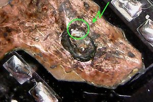

some five years after purchase my late 2012 iMac (EMC 2544) suddenly went black with smoke (!) coming out at the top. Apple here initially diagnosed a broken power supply, and later claimed some additional (unspecified) damage, returning the machine without suggestion for a fix (well, buy a new one...).
Opening up the machine I found the power supply unharmed and working, but a mechanically damaged SMD capacitor on the logic board near the two display connectors. The capacitor was shattered, powering up the Mac produced fumes and sparks that had eaten their way around the area charring the circuit board. Not a nice sight. I removed the dead capacitor, cleaned up the charcoal, epoxied some insulation onto the board and soldered a new capacitor in place (SMD soldering is fun...). To my greatest joy the Mac now starts up without fire and smoke, and the four green LEDs on the logic board light up indicating everything is fine. However: the display remains black. Second however: an external display (attached via Thunderbolt-to-HDMI converter) works perfectly fine. And the System Preferences (Displays) do show the black internal display! This makes me think that the internal display is still sound, but that the sparks killed the inverter circuit for the LCDs backlight.

two images added (@oldturkey03 thanks for pointing out how to do this!). First picture shows the location of the defect, second picture shows the shattered capacitor plus its specs. I did remove the broken one plus the intact one just above it to be able to identify it. Then I replaced both with a single SMD capacitor of double capacitance (4.7 microF), as the original two were connected in parallel. Soldering just a single SMD component in that damaged area was more straightforward than soldering two.

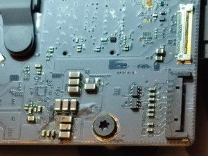

@oldturkey03 Thanks for your help! Below is two more pictures of the identical PCB area back and front, before any repair attempts (for orientation: the bolt hole in both pictures is the same one; bottom right and bottom left show the identical end corner of the PCB). I hope they cover enough area for component identification per schematic. As for the broken traces issue: so far I looked at the board as having just one copper layer on each side, with a black protective coating covering everything. Am I wrong, is there actually two copper layers on each PCB side? Also, is it true that the schematic shows several versions of particular circuit sections, meaning that not everything shown in the schematic is actually present on the PCB?

@Gigabit878 I do agree the board looks prettier before the repair. However, when under power there was continuing sparks worming around and steadily extending the charred channels visible in the picture before repair. As this charcoal has significant conductivity I had to remove it with a small mill, going deep enough to expose clean glass fiber/epoxy. To double up on insulation I filled the milled sections with epoxy.
@oldturkey03 the pads of the original shattered capacitor ended up not being solderable anymore. However, the pads of the second removed capacitor (the middle one of the three visible in the pictures) still are. So both 1210 are now connected to the pads of that middle one. To the best of my judgement no traces have been broken in the damage or repair process.

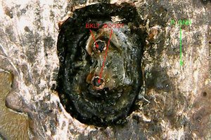

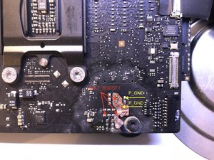

Update (03.12.2018)
I found the short circuit. it will probably have many the problem or get it soon
the GND and BKLT BOOST lines are exactly on top of each other. fatal is the mini badly insulated line from bottom to top, between C9799 and C9709.
I try to repair the place. Unfortunately, Q9702 has died too, it does not output 12V_BKLT_PWR anymore .12V_S0 input are ok.

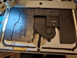

Hi,
I read all the discussion because I found a similar problem in my iMac (late 2013,21 inch):
As you can see in the picture the capacitor exploded and I get black smoke out and when I connect the iMac with the LCD panel still stinks of smoke.
Without the panel the machine boots flawlessly, by connecting an external monitor I can get it working.
I need the rating of the blown capacitor shown in my picture, can you help me? Where can I get those schematics? I really need them.
