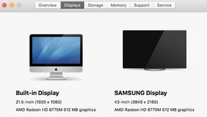

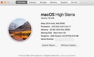

Just so this information can be seen, here’s the ‘About This Mac’, ‘Overview’ and ‘Displays’ from my 21.5” 2010 with the i7-860S CPU, 32GB RAM and the Radeon HD 6770M GPU.
I case there are any questions about the second 43” display with 3840x2160 resolution. I’ve got a 4K TV that wanted to also use as a secondary monitor, but a basic Mini DisplayPort to HDMI adapter could only feed 1080p. After some search, and a couple of products tested by trial and error, I found two that gave me this 3840x2160 resolution. Ones the Plugable brand: Active Mini DisplayPort to HDMI 2.0 Adapter, the other is the Cable Matters brand: Active Mini DisplayPort to HDMI Adapter. The image is outstanding, and higher resolution than I expected to get since all the specs I found list the max secondary display resolution of 2560x1600. The only drawback is that I have only been able to get 30Hz.
