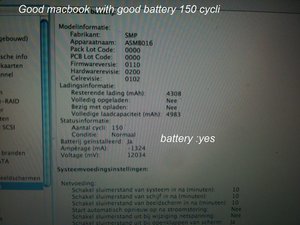

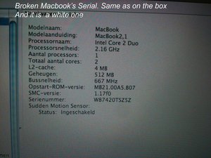

Okay, the story continuos,
Today i put it back together again so that i could make some screenshots. I wil post the images also to back up my story.

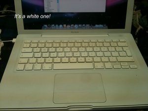

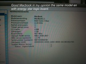

I have two macbook, both with an energy star logic board and both core duo 2.16. The serial of the good one is W8734089Z5W the broken one is W87420TSZ5Z Both are a white model.

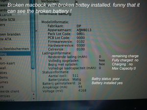

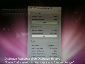

I have 2 battery's one is not good and can not be charged anymore. one is fine only 150 Cycly of charging.

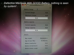

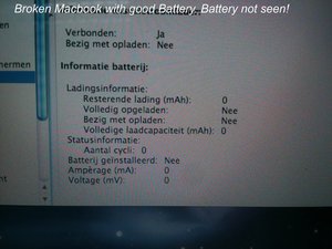

If i put the broken battery in the broken macbook, The Battery's is seen by both system and cocnut. but of course i isn't charging magsafe green light. If i put the good battery in the broken macbook both system and coconut can't see it and again it isn't charging.
