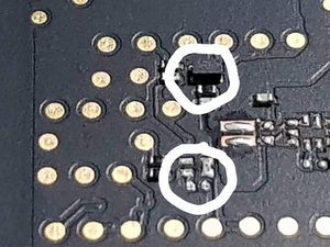

Hi! I have the same issue and I found out one of my transistors, more specifically Q6050 was mising from my board. It was yanked out most probably during reassembly. (Oh yeah, and a resistor too)
As you can see the trio of black resistors and the transistor in between should be complete each fan but the one at the bottom has missing parts.
The transistor is the black block while the resistors are the silver ones with a black middle. I've ordered these parts online and I'll get back if it fixes the issue.

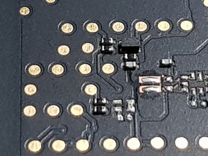

I have a 2017 A1707 mlb 820-00928 with high fan speed only on left fan. HWMonitor not showing any high temps which doesn't suggest a sensor issue. I was thinking that it was possibly a PWM issue from damaged/missing components so I Googled and found this thread. Mine was the same issue, missing Q6000 the mosfet for left side fan. https://imgur.com/a/BQ1LDYj Two pads missing and the left hand pad had a via under it which goes to pin 19 of KBRD connector. I repaired the pads with some jumper wires see here https://imgur.com/a/zaExsx9 Thanks to the other posters for their info #righttorepair #repairnotreplace

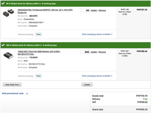

I already bought the missing parts but the problem is I need quite a bit of skill as well as a hot air workstation. Hopefully someone would be able to fix theirs using the info below:

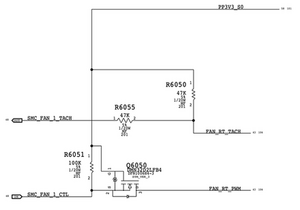

Here is the fan control circuit on the board (It’s missing a MOSFET-[Part#Q6050] and a Resistor-[Part#R6051])

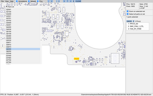

Here’s the location of the parts on the board

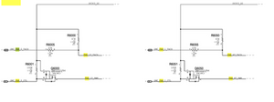

Here’s the diagram for the fan control circuit

Very lucky at the end damged component were found while i was puting A1707 togather keyborad flex which were lefted under the mainboard and pressure cased the damaged to component,reslodered same one but did not work so i have to run a jumper and worked for me
@Syed Shah Loor right under the keyboard connector. Bottom side of PCB. You need to remove the board.
