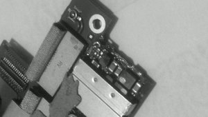

The backlight ic ic located under the EMI shield, where the Cpu and power IC are located.
In order to replace a backlight IC for ipod touch 4th gen u have to take off the entire emi shield and also the metal piece under it. You have to carefully break it off, i have done this many times but it takes patience.
Once you do that, its located on very top right hand corner near the PMIC

I took a picture of a broken one I am using for parts. The IC is removed but you can see where the solder pads are. There are six small pads and two larger pads between them. They are located just below the circular pad trace. Hope this helps.
