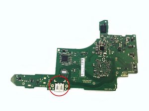

On this topic I was replacing a charging port and my kids came running in the room and bumped me, I have now lost a micro capacitor from the back of the board. Does anyone know what one I need . It’s on the back of the board second line up from the usb c port. There are a line of them in pairs of 2, 8 in total. I pulled this image from the net but it’s basically the line that runs on the outside and top of the red circle not inside it.
