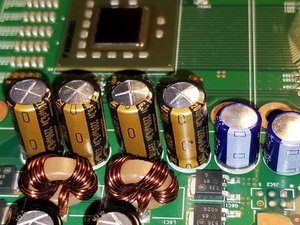

I currently have the console taken apart again. I applied some liquid flux around the GPU and did a more focused reflow on the CPU and GPU, without removing the additional heatsinks I had put on previously (only removed the two stock ones). Whatever the brown substance is it was very stubborn to try and clean with some 91% rubbing alcohol, but I got it at least partially off. Doing the new reflow caused the same thing to happen again. Unfortunately, some more capacitors are looking a little sketchy with very minor bulging on the top, but I don't want to waste more time and materials replacing caps unless I know it could help.

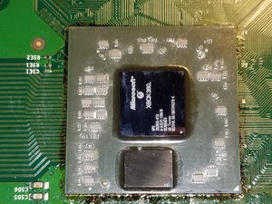

GPU:

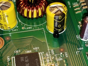

The small chips by the GPU, also with the goo:
The same as above, but through a 60x pocket microscope. Sorry, this was the best I could do with my phone's camera pressed to the microscope lens.
Sketchy capacitors:
@seiryu “the x-clamp fix had been done before” The kit is strictly providing additional pressure on the GPU/CPU to try to close cracks in the solder joints ( as well as reconnecting the bumbs, long story). You most likely have issues with your GPU processor. It does look like residue from leftover flux. you already know that it was worked on so somebody else may already have tried a “reflow”.
Most of the failure is because of the flip chip design CPU/GPU and the issue could be the solder bumps between the IC and the substrate. Here is a very "quick and dirty" explanation of what causes most of the RROD. It is not always a failure of the solder balls which connect the Flip Chip BGA package to the motherboard. It does happen and you can see why [ http://www.bunniestudios.com/blog/?p=223|on here] More commonly however is that the failure is due to the chip design itself.
As you can see the "bumps' are what actually connects the die to the substrate to make the chip complete. If these bumps fail the die does no longer make contact either he substrate and thus no contact with the circuit board. The chip has failed.
Here you can see the space where the bump has failed and no longer makes contact. We are talking microns of space here. So a bit of pressure on the top of the die potentially close the gap. Same with a reflow, it may allow some of material from the bump to reshape and starting to make contact again. The heating of cooling of the chip during use is what will eventually cause it to fail again.
So, I put everything back together just to see if my second attempt did anything, and now the error code is 0003. I guess I have an extra Xbox for parts now, since it is absolutely not worth it to get what would be required to do a full reball, and I know even that may not work.
Thanks for your help!
1 and 2 are likely leftover flux from previous rework attempts. So this is a board that has already been repaired, or tried anyway.
RROD is not solely caused by bad BGA soldering, so just reflowing may not work, especially when it worked for a little while after the first repair. Now the board or the GPU is completely toast.
Considering the value of it, it is unlikely economically repairable.
