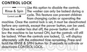

With the machine turned on, you need to press and hold the Rinse and Spin button for 3 seconds to disable the Control Lock option.
See p.22 of the Kenmore 31552 use and care guide.
Control Lock + padlock symbol should also be printed on the panel under the button on the machine
Here's a poor image taken from the guide that may help.
(click on image)
