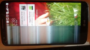

Look at the attached picture what happened to my phone. It fell and now I can see only 2/3 of the screen!
Do I need to change the digitizer? The LCD screen? Both?
Any advice would be greatly appreciated.
shia10 This is an LCD fault not a digitizer issue. Replace the display assembly unless you have experience with separating it etc.
