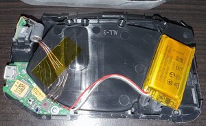

Hi. I have problem with the top connector in my Plantronics Voyager 5200 charger case.
I need to open the unit but I can´t

Yes, you can open this case. There are two small hidden screws. They are near the hinge, and under the rubber liner on the inside of the case. You call peel it back with a small, flat tool and maybe some gentle heat to soften the adhesive. Start in the corner near the hinge, where the ear piece sits when the headset is stored in the case.
After removing those two screws, you can pry around the top edge of the case to release the snaps and it should come out. There are some small magnets to retain the headset, so don’t lose them when opening.

i had a usb dongle stuck inside the case that i needed to get out. disassembling helped.
see post below from another user with pictures.. that further helped locate those two screws "inside" the case :)
Thank you gee-one for explaining this, I've been struggling to open this thing without ever realizing that there even was a liner!
As noted in the accepted answer, the two screws are in front of the hing beneath a rubber liner inside of the case that the earpiece rests on. I was able to slip a thin metal jimmy under one edge of the liner and lift it up pretty easily.

Hey. did you manage to replace the battery? Any parts, recommendations?
I got mine opened and found the battery is soldered in.
Li-Ion Polymer Rechargeable Battery
DIJ652037SA 1ICP7/20/37 (RED+)
3.7Vdc 440mAh 1.628Wh
207650-02
I got mine open and found battery
AHB651935PST-01
420mAh 3.7v Li-Ion
After some digging, I couldn't find a replacement for either battery model. Your model seems to be made by Tianjin Lishen Battery Joint-Stock which was auctioned off sometime in 2021, and mine seems to be compatible with charging case for Sennheiser CX Plus released in late 2021, but again, without a replacement.
