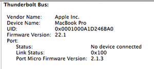

DAN! Okay I found out what the problem is, you're going to want to make a note of this as it will be helpful to others.
Firstly, I stumbled across this which provided clues https://discussions.apple.com/thread/787...
It's the firmware that is the issue! I noticed both the 17" models that wouldn't power on my interface had the same firmware as I posted in the screenshot! Firmware Version: d.0, Port Micro Firmware Version: 1.2.1
Unfortunately the correct firmware cannot be installed from any of the later versions of OS X (not sure from when, but presuming Yosemite?) so after a late night and a lot of mucking around I managed to get Mountain Lion 10.8.5 installed onto a spare toshiba drive I had, for some reason I couldn't install from an external caddy either so had to mount the drive internally. I also ran into an an error regarding installing from usb "There was a problem installing “Mac OS X”. Try Reinstalling". Considering how much time it took me I'm very relieved that my hunch was correct!
I downloaded this here: Thunderbolt Firmware Update v1.0
The newer updates 1.1 and 1.2 did not work at first saying "Your computer's Thunderbolt port does not need this update" and 1.2 says something about needing to be on 10.9, but I installed Thunderbolt Firmware Update v1.0 and then I was somehow able to install Thunderbolt Firmware Update v1.2 afterward.
Now I just have to switch back to my SSD and go from there but at least I can see it's powering up now :)
Note to anyone reading this: Make sure you're plugged into AC power or the firmware update won't work (quite possibly why it didn't automatically update the first time around back in the day!). Also, take your time and breathe ;)

And now here's the Thunderbolt info:
Bus Thunderbolt :
  Vendor ID: : Apple Inc.
  Nom du périphérique : MacBook Pro
  UID : 0x0001000A156383E0
  Logical Unit: 0
  Version du programme interne : 22,1
  UUID du domaine : B6969003-5485-245E-8FED-2538703498FC
  Port :
  État : Aucun périphérique connecté
  État du lien : 0x101
  Vitesse : Jusqu’à 10 Gbit/s x2
  Réceptacle : 1
  Version du programme interne de Port Micro : 2.0.7
to compare with the old ones.

Thanks Elektrosha for this. I still have my 2011 MB Pro with non working thunderbolt so I'll go back and try again using your advice. Will let you know how it goes!
First of all thank you for finding out a way to fix the thunderbolt problem on the 2011 MB Pro. I’d like to install the newer firmware on my 2011 machine too. Because I have a recent OS running (Catalina) I need to boot from a Mountain Lion image which I have on a USB key. I can boot from it but does anybody know how I can then run the firmware update file? Do I need to go into terminal to do it because the only options I have when I boot from USB are restore time machine backup, install Mountain Lion or disk utility but there seems to be no way to browse to the firmware update file to install it. Thanks in advance. Rob
Hi leggy, if your MB pro runs Catalina then it is most likely not a 2011 model. The latest Mac OS that the 2011 MBPs can run is High Sierra. So, better check out your model by clicking on the menu bar Apple logo and choosing “About this Mac…. ” and then search the appropriate firmware installer for you machine.
I haven’t used a bootable USB installer Stick for my updates. I have installed the OS on a USB drive and booted from that.
Regarding the firmware version, you (and other’s who are coming here by search engines) should be aware that every Mac generation has their own firmware versions (and version numbers), probably because the hardware is a little different.
So, regarding the early Macbook Pro 2011, 17” model and probably also the 15” model, I am quite sure by now, that Thunderbolt firmware 22,1 and the Port-Micro Firmware 2.1.3 are the most recent versions.
And in addition to that, I happily found out that the updated Thunderbolt can now run a Thunderbolt 2 dock, which it couldn’t before.
Hi Wolfgang. Thanks for your reply but mine is a 13" 2011 MB Pro and they can actually run Catalina. If you do a search there's a very simple method and it actually works very well. So in fact you're saying that rather than booting from a USB key I should install OS X Mountain Lion on an external drive and then boot from that to install the Thunderbolt firmware update as the original poster did above to fix his problem on a similar machine to mine? That's the problem I'm having just being able to run the installation file. I'll give that a go. Thanks.
Yes, that was the procedure that worked for me. But I had to go all the way from first the 1.0 update then to the 1.2 update.
Off topic: I would avoid Catalina, as long as I could. But the install process means a lot of disadvantages for my computer (even with Mojave), so I didn't even try it out of curiosity.
Good luck!
I still can’t install the firmware update (getting that software is not supported by this system). I’m suspecting it’s because my firmware version is up to date (27.1), but not the Port micro Firmware version 0.15.0. I’m suspecting it’s that latter one causing the problem of not detecting the device.
Do you have any other clue how to update that micro firmware?

I have a MBP Early 2011 and the Thunderbolt version are there :
Bus Thunderbolt :
  Nom du fournisseur : Apple Inc.
  Chaîne de routage : 0
  Version du programme interne : d.0
  Port :
  Réceptacle : 1
  Version du programme interne de Port Micro : 1.2.1
My os version is 10.13.6 and the update firmware 1.0 :
https://support.apple.com/kb/DL1407?view...
don’t work. I have try with Mountain Lion, Maverick, Yosemite and the response is alway :
“Cette mise à jour n'est pas nécessaire pour le port Thunderbolt de votre ordinateur.”
“This update is not necessary for the Thunderbolt port of your computer”
Il don’t know if there is a way to force this update?
I will try later with a clone of Snow Leopard 10.6.8.
If somebody as an genial idea, thank you in advance.
John
Update (10/21/2020)
I have try with Snow Leopard, same response : “This update is not necessary for the Thunderbolt port of your computer”
i'm desperate. :-(
Hello.
Nobody can help me?
Hi Jean JD, I have read my own post here again (it has been a while), as well as your information. I can only guess where the problem could be.
In contrast to you, I have done the 1.0 update in Mac OS 10.12 and I did the Thunderbolt 1.2 update in Mac OS 10.9.
With some older Apple installers I have experienced that the signing has expired over the years. And error messages can sometimes be misleading.
So it may be worth trying the 1.0 update with Sierra and if this doesn’t work, with the date set back to or before September 2019 (and make sure your computer is offline).
Sierra can still be found here:
https://support.apple.com/de-de/HT208202
(And if you want to create a bootable Sierra USB-stick, I have managed to do that with the “Sierra Patch Tool” by “dosdude1”, but that is a different story.)
Good luck!
