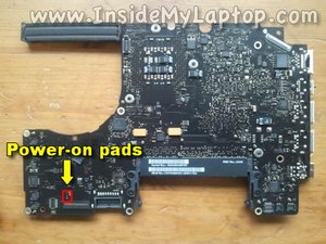

Thats a picture of the two power pads I was talking about..the two small squares to be shorted together..nothing else in that area, you can't miss or confuse them

Thanks, arbaman! All is as you stated. Only thing wrong is that it still doesn't turn on! There was no charging apparent (green LED) on the installed battery, but that's because it's fully charged, I believe. Substituting another battery and using the charger, indicates that battery is being charged (orange LED). However, still no start with either battery or with charger attached. It almost seems as if the power button switch isn't working, but I don't know where those leads are, so can't check it...
@doug Good, better a topcase/keyboard than a logic board fault ;)
Right under the 4th keyboard pin you can see the two power pads, top one 3,4v and the bottom one grounded. Short them with anything metallic and see if it starts to get confirmation it's a keyboard fault.
Maybe try reseating the keyboard cable better if after cleaning it with alcoohol..you might be in luck and it's just misaligned.
Oh, boy! Please excuse my ignorance. I have no clue about which pads you're referring. Can you direct me to a pic, or perhaps more extensive word description? I'm very reluctant to short pins together unless I know for _sure_ which are the correct ones!
BTW, thanks so much for your help!! Without schematics/wiring diagrams, this level of troubleshooting is nearly impossible!
@doug there you are, answer updated to include power pads picture
@arbaman, not sure if I got the right pads. When I shorted them, flames shot out...
Nah, not really!! You "da MAN"! Shorting those pads started the machine right up, and it proceeded as if it knew what it was doing. So, I shut it down with the menu normally, tried the start button, no joy. Started again by shorting, everything normal, shut down, start button failed to work second time. Does this mean a new keyboard, or is the start button itself replaceable?
