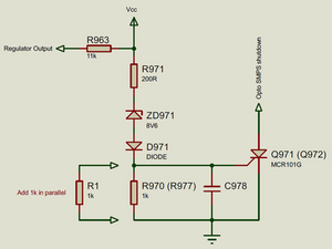

A number of my colleagues have dual U2413f monitors on their CAD workstations. One of them has developed the same fault as described in this thread, it shuts down when it heats up.
I saw the solution of changing the thyristors to ones with less sensitive gates. I couldn’t easily get suitable replacement parts locally, so I looked for a different solution.
I drew out the schematic of the crowbar circuit which has a standard configuration. I decided that a simpler method of fixing the problem was to stiffen the Zener bias resistor to keep the thyristor gate voltage lower during normal operation.
The simplest method of achieving this is the put 1k in parallel with the existing 1k resistor resulting in halving the value.
The best part of this fix is that it can be done from the back of the PCB without unscrewing it and removing it from the metal frame.
For the benefit of others here is the process:
1.       Using a plastic guitar pick type tool along the seam between the front bezel and the back of the case, press in the clips and release the bezel.
2.       Place the monitor on its front and carefully lift off the back.
3.       Lift the metal shield and carefully peel the ribbon cable adhesive pad off the LCD.
4.       Press-in the clips and release the ribbon from the LCD.
5.       Fold over the PCAs to access the back of the PCBs.
6.       If necessary, the PSU PCA can be removed by squeezing the release clip on the inside of the PSU SIL connector on the signal PCA.

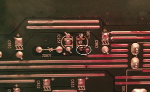

7.       The thyristors in question, Q971 & Q972 have 1k between their gate and cathode.
8.       Reduce the Zener bias resistance to 500R.
9.       Solder a 1k 0805 on the gate and scrape some resist off the ground plane and solder.
Since carrying out this modification the monitor has not had any further problems.

Seems legit. I have one more monitor, that I might try this on. Hopefully, no issues arise by the additional stress.
Dołożyłem opornik zgodnie ze schematem. Wszystko działa jak należy.
Super !
Works as a dream. Wszytko działa jak należy. Thanks.
Sorry for my poor english but I don't understand the meaning of :
"scrape some resist off the ground plane and solder".
If someone could explain, it will be great...
Can you provide a link to the 1k 0805 used?

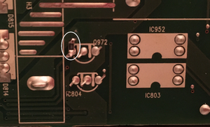

So the two thyristors are the answer for this problem. Q971 and Q972. Unforunately the original MCR part had a non-standard arrangement of Gate, Anode, Cathode (K) leads, and there are none I could find with the correct order, so you MUST bend the pins to have the right one go to the correct hole on the board, changing the Littlefuse Thyristor from KGA pin order to GAK order to match the original part - you CANNOT use the default arrangement.
The replacement part you want is Littelfuse S4X8ES2, and mouser.com has them for 45 cents each - the $7.99 shipping will be the most expensive part of this. I ordered 4 since they were so cheap so I had spares in case I accidentally broke a pin in the bending process.
The data sheet for the part is here: https://www.mouser.com/datasheet/2/240/L...
To open the case on your Dell U2413, I highly recommend the ifixit kit with the guitar pick things (or actual guitar picks). They get the case open without marring it.
I’ve attached a few pictures showing where the parts are on the power supply board in the monitor and also how to bend the pins of the replacement thyristor so it has them in the correct order when you solder it onto the board. This will stick up a lot higher than the original due to the bending (so you don’t have any of the legs touch - DO NOT HAVE THEM TOUCHING EACH OTHER AT ANY POINT), but that’s no problem.

Perhaps suitably sized heatshrink tubing over the component legs will reduce any inadvertent short circuiting.
Just a thought.
Yeah, that's a possibility. If you bend pin 1 three-dimensionally (I went back, over, down, forward, down) there's no chance of it touching the other two pins. Since the point of this part is temperature sensitivity, I wasn't sure if adding tubing might throw that off by insulating the pins, so I decided against it and just went with careful bending.
It was just nice to get this monitor working again for a little over $10 Finding the part was the hardest part since I originally searched for a 1:1 pin compatible replacement and came up short.
