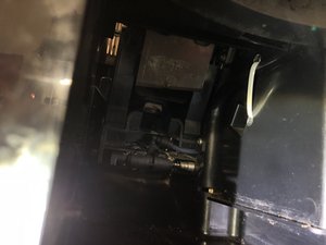

I just had this problem. I pulled the motor, unscrewing the two Allen screws. The top mount was cracked. I reinforced it it and added a large washer that I ground down on one side. The motor still would flex and allow the gears to slip. I found that pushing in on the opposite end of the motor stopped the excessive flex and it worked fine. I used a small (5/16”) paddle bit drill and drilled one hole on either side of the rear of the motor. The holes went into the area where the ground bucket is. I checked for clearance and ran a large zip tie through one hole and back through the other one securing it around the motor, cinching it tight. Testing the machine, the motor does not flex as much anymore and it will now run the cycle. The rear of the motor has one fastener that is just a rubber bushing. This is to allow some flex. Time will tell if my repair is successful!
