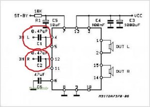

awr1-1w. When I turn it on there is a very short, loud buzz from speakers. Then no audio output. display works fine and shows choice of station and time when turned off. keypad on top functions perfectly just no audio after initial loud buzz.

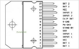

Hi Mate, not sure if you’ve managed to fix this thing yet as it’s been a few years, but I fixed mine (which had the same fault) today by replacing the two small 0.47uF 50v electrolytic capacitors in front of the amplifier chip, hope this helps!
This absolutely worked on my radio. Capacitors cost 54 cents each. Shipping was $5. Still worth the price of admission
