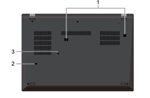

Well, for a Lenovo laptop, try to find in a documentation about Battery Reset. In some models, there is a hole through you can do that and somehow recover battery status. Doesn't help too much if you have a bad model, like I do: T470s, battery 2.5h when a laptop was new. Now, I am afraid to test.
Try the emergency reset hole.
Mine wasn't charging either so I tested Lenovo's suggestion by pressing down on the reset hole button for 10 seconds with a paper clip. Charging light came on after holding the reset hole button down for about 10 seconds.
T490's reset hole is number 3, it's above the screw on the left-middle on the bottom
Link to Lenovo instruction page:
Lenovo T490 and P43s
