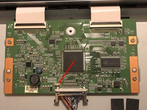

Here is a picture of the whole back and each board. It is model KDL-40S504. I have a multimeter as well.
Update (04/11/2018)
I tried to see if it was in standby mode. It didn’t work when putting in the combo with the remote. Here is a picture of the T-Con board.

@joebrown this does not sound like a backlight error from a failed inverter etc. You most likely would have audio with it. Your error sounds like a bad power board since you have neither. Let us know what exact model this is and post some pictures of your boards with your question. You'll need some basic tools and a multimeter to test things later on.

I need one more picture of the T-con board. That is the board on top of the TV where the cable from the main board plugs into. There will be a fuse on that and we need you to measure continuity of the fuse and later power to the fuse when you turn the set on. You also want to post some more images of the boards just zoom in a bit more so we can check the components closer.

check the fuse for a. continuity. After that check to see what the voltage is on it when you turn your set on. Red probe on either side and Black probe on chassis ground meter in VDC

I tested the T-con board fuse you suggested and it had 25 volts when I powered on the TV. Any suggestions from there?
okay so you do have power to the T-con board. Can you check on your power supply connector CN6701 for the proper voltage going to the balancer board?
