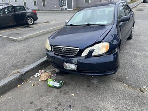

@abassokhiye what is your question? The damage you are showing can't be fixed by resetting the service light. Also, please pick-up the trash. if you are in Maine, there are plenty of recycle bins. There is no reason to litter :-(
