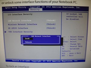

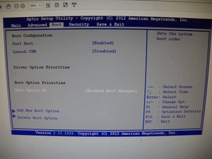

You have to go in bios to security option then disable USB security so it will be able to boot to USB drive, then go to boot options and add New boot option that will be the USB, then make it boot option 1.

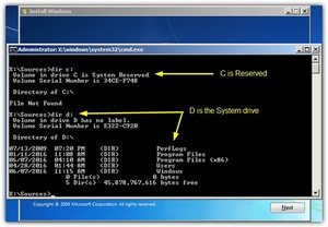

3. At the language and keyboard selection screen press Shift+F10 to open a Command Prompt. You should see X=Sources>, now type bootrec /fixmbr, it will say completed successfully. Stay at the command prompt, now on to the check disk
4. What is usually the system C drive may not be here because if there is a system reserved partition it will occupy C instead. To find out type Dir C: and if it says “C is System Reserved” try Dir D: and so on until you find the drive with Program Files, Users and Windows folders.
5. Now you know the assigned letter for the system drive you can run Check Disk
At command prompt X=Sources> type the letter of drive you found in previous step, example X=Sources>d:
You should see this now D:\> type chkdsk d: /f
You should see this D:\>chkdsk d: /f then hit enter to fix hard drive
If it says do you want to force dismount answer YES
i dont see any usb security under the security tab, is it the secure boot control?
That is probably it, secure boot control, you should be able to disable it, may be a little different than how I explained it, just as long as you can boot to USB drive.

Just go to bios and make csm enable
After that save and try
