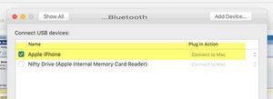

@James Tompkins, it lets you type the password, it's just NOT shown to you as a security measure. Just type your password completely and press enter

I’m trying to run the Kill commands and when I do it says password with a little lock... but it won’t let me type my password? Anyone know how to do this? I can’t plug my new phone into my new MacBook :(
Mine is the same way. Type the password anyway and hit return. It really is getting your input. I know: crazy.
it is a security feature.
