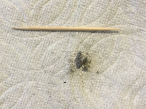

Lightning port too loose?
Looking for suggestions or similar symptoms to diagnose.
Lightning cables will just not stay in this phone if either is even shifted to the slightest. Unscientific measure; I used to be able to pick up the dropped phone by the cord alone without disconnect. Now ANY pull or pressure and the cord comes out. I don't see any debris in port, but my eyes aren't perfect. I can't tell if there are pressure levers or contacts that I see inside on left and right, and maybe one is bad?
YES, it still connects to laptop.
YES, it still charges fine.
YES, i tried original cable.
YES, i tried a NEW original cable.
YES, the cables 'pop' in/ fully seat.
NO, there is no case.
YES, i tried with a passthrough case.
help?

Worked for me. Thank you. I found that the lightning port was about 25% packed with lint. Pulled it out and now it works.
Pretty slick....... thought it was a tech repair or replacement! Just like new!!
I had this happen before I think because I keep it in my pocket. I used a plastic toothpick and out came the lint. Not a ton. Blew in it. Some more came out and finally pulled more out. Don’t think I got it all but same as y’all charging cable in, Apple car play came right up and it’s not slightly loose!!!
Perfect Solution! Thanks.
Boom! That did the trick!

Okay, I had been facing the same issue since the past couple of months with my more than 2 yrs old 6s. Today, just moments back & out of curiosity & boredom combined, I took a tooth pick & started scraping the inside of the phone’s charging port. To my surprise, a shitload of debris started dropping out. After about some ten minutes of ‘not so careful’ scraping, the port looked clean. Post which I checked for charging, & the “lose port” problem disappeared. Contrary to my belief as per which, more the debris inside the port, tighter should the connection with the cable upon plugging in become, cleaning gave that rock solid port-cable grip back. Apparently, the base of the port starts getting deposited with debris, & hence, the cable does not fully go in, which results in a fragile connection. Do give it a shot!

I thought I posted this myself long ago, but I was wrong. I scoped it, no dirt. I brushed it, no dirt, i aircanned, no dirt. Then one day a massive hunk of micro-debris, pitch black, came out on its own. I had checked for exactly this and never saw it. 3 pickings and 2 phones later, same method fixed all. Not sure what tool i would recommend to do this. do they still make those flat wooden toothpicks (NOT round)? plastic floss stick?

This is what I removed from the lightning port (not the dime)

Yep worked for me too. It’s like belly button lint build up. I used a flat tipped plastic toothpick. The port is deep... Keep digging!
CRAZY! I too thought it didn’t make sense that stuff in the port would make it seem loose but it’s true! I used a toothpick, scraped pretty hard for two minutes and it’s perfect! I can’t believe I’ve battled with poor charging for months, thrown away charging cords that I thought were the problem and was about to pay $85 for a Apple “technician” to repaire it. What a rip off! It took a free toothpick from a restaurant and two minutes and DONE! Thanks for the help!

id start with a dental pick or needle point tweezers, in order to pick out poket lint, which is the number one cause of this. (taking it to a repair shop, they will charge a benching fee for some time, and do it properly.)

Not a good idea. Any metallic object will short out pins, potentially causing destruction and it is much harder on the Gold plated contacts.

Not a good idea to use any sort of metal pick.
There will be a connections to the phonez internal battery and a short circuit may cause internal components to fail or potentially cause a battery explosion fire.
Metal scrapers will/can cause the very thinh layer of gold to become damaged, which then caused oxidation of the contacts resulting a very rapid failure.
