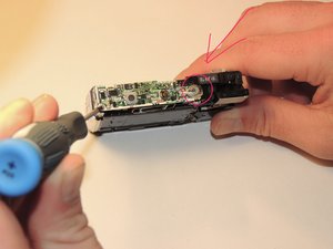

Camera works fine except for the fact every time
I take out and replace the rechargeable NP-200
battery I have to set the time and date..
Thanks I removed the dead battery and am trying to find a replacement
but looks like I will have to add solder tabs on to a watch battery that is
similar in size..
Your backup battery i have marked up in pic. Most likely it will be in a rough condition:) you will need to desolder it and replace it with similar size 1.2v battery
