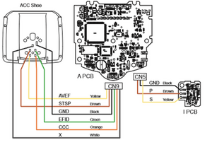

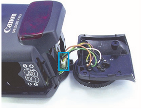

So I was shooting on a tripod this afternoon when I suddenly tripped on said tripod. It fell on the floor with the flash mounted to top of the camera. The top part of the flash detached leaving the base mount stuck in the camera. Only 3 wires out of 5 remained soldered. I had to force-remove the remaining wires in order to be able to detach the mount from the camera. Here's a picture to better illustrate what I mean. Besides that, I might need to work on the lock mechanism which seems a little off as well.
So the big question for now is which wire goes where? if someone has a diagram, that would be great as I couldn't find any online.

Hi Eric,
Please see attached pictures.
Let me know if you need any others.
