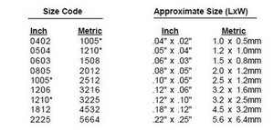

Can someone tell me what the component labeled F5
on the mainboard is? What is the value of this mini-component?
Is there anyway I can get (order) this part online?

@kerry1 yes that is a fuse. You will have to clean up the solder pads and measure the distance from pad-to-pad to determine the "package size"
Once you know the package size you can visit sites like mouser.com or digikey.com (yes ebay.com may have those as well) and order a few fuse. I'd go with a 6V 1A minimum or a 2A maximum fuse. Solder the new fuse in and see what happens. Hopefully this is all that got destroyed during the over-voltage.

As @oldturkey03 said it most probably is a fuse as in electronics F is the designation for a fuse.
There is always a reason why a fuse blows, especially as in your case it has done this so spectacularly.
Do you know of anything that may have caused this to happen?
Replacing the fuse may not solve the problem as there may be more damage further into the circuit.

In the absence of a circuit diagram, (cannot find one), I can only suggest that you initially connect an Ohmmeter between the 'output' side of the fuse F5 (i.e. the side not connected to the +ve DC input connector terminal) and the -ve DC input (or Earth terminal) connector and see if you get a reading at all. There should be some resistance (Ohms) reading of some value, not s/c (short circuit) or very low value. If there is no reading at all, reverse the leads and check again.
If there is still no reading (i.e. o/c -open circuit) then there are more components that have failed.
All you can do then is to do point to point testing with the Ohmmeter and trace the paths from the fuse to the next component and from that one to the next etc, drawing and labeling the circuit as you progress.
Hopefully the damage will be limited to the power input section.
