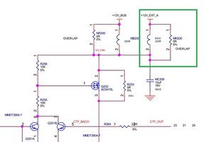

Trying to understand what is broken here, so I can replace the parts.. believe it says r200 where the part is burned.

That is fuse for +12V supply.

@hendricorico no, it is not a fuse.
Graphics card Schematics Sapphire Radeon RX 570/580 https://drive.google.com/file/d/1ylcnbtS...
B200 = R220
its not the same
What is the name of that Burnt Smd?
yes its a resistor with r200 and mr200 written above it but finding the value and package size could be difficult

i would only be guessing as theres no schematic i would probably try 0603
most r200 is see are 1w 1% so any resistor around that
where i can get that...0603 r200? :)
you could probably get them on ebay just type in r200 0603, it will probably not have r200 on the top tho. the thing is how many ohms it will be
@xuw here it is almost 6 years later and I am certain you have replaced your video card by now. Just for completion sake, check the reference designator on the PCB
. It says B200 and MB200, so it is not a resistor. It is a ferrite chip bead inductor. In this case it has a impedance of 220 Ohm 2500mA 25% in a 0603 package
