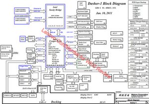

As I have read in many other threads, I could see that it is able to install a mSATA drive into Lenovo X220. But what I wondered and couldn't find the answer is, will install mSATA drive will replace or disable the Wireless function? Because I saw that many thread told to replace the mSATA for the Wireless Card. That Wireless card, is WWAN card, or the WLAN card? Also, is it possible to install and enable all three of them at the same time?

I don't think that you can place a mSata drive into either the WLAN or WWAN slots, as they are both mPCIe slots, not mSata slots, even though they look the same.
It won't work, unless they are combo mPCIe / mSata slots that can be configured in BIOS, but there is no mention of this in the service manual.
You may be able to use a mSata to Sata adapter and install the mSata in place of the HDD and insert the HDD into a caddy in the DVD slot and lose the DVD drive, (or replace the DVD drive with an SSD).
Although there is an argument that a SSD is just as fast as a mSata drive so if you have a HDD installed just replace it with a SSD and replace the DVD with the HDD for more storage if needed

The X220 has 2 mPCIe slots. One for WiFi (WLAN slot), and the other for mSATA or cellular (WWAN slot). The WLAN slot cannot be used for mSATA.
Lenovo does support mSATA in the WWAN mPCIe slot, but as it is a single slot, it can have either WWAN card or mSATA card, but not both simultaneously.
