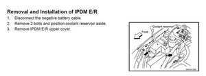

Where is the starter relay located
Are there more than one location for the starter relay on 2002 Nissan Altima 3.5
Usaually it is just in the engine compartment
@tammywhite it is located under the hood on the passenger side of the vehicle. It is part of the "Intelligent Power Distribution Module Engine Room". Fancy name for fuse box I suppose :-)
