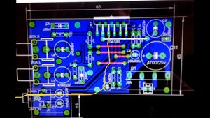

I've been using my Mackie CR3 monitors with my Mac with no trouble for about 2 years now. Suddenly when I turned on the computer today I realized that no audio is coming out of the monitors.
The monitors are powered on (the green light surrounding the volume knob is on.) And strangely, when I connect a pair of headphones to the Aux out port in front of the active monitor, I can hear well through the headphones.
Does anyone know a fix for this?

I picked up a set of these from a wholesale liquidator auction site and had the same issue. I tried replacing the amp chip but no good. Finally as a last ditch effort before throwing them away, I cut pin 5 on the amp chip (TDA7265) which was the mute pin. I get sound from the speakers now, but they don't mute when I plug in headphones, which is fine by me. Everything else works as intended it seems.

Pin 5 is the 3rd pin from the left, that you can see from the top. Cutting this pin worked a treat to solve my problem. Looking at the datasheet, the amplifier could be in off/standby/mute accidentally, cutting the pin seems to force the input to 0v, which triggers the amplifier to turn on. This would explain why turning off the speaker will make audio come out briefly -- the headphone jack is not muting the amplifier, but the off/standby/mute circuit is behaving improperly. I notice the amplifier gets quite warm inside the sealed cabinet, so it could be due to a component value going out of spec over time. (I bought mine second hand).

The real problem is sometimes further in the circuit. Like ‘forest’ was saying in another topic I fixed a couple of them by replacing only the z4 zener diode. It gets really hot during operation, and stuff just breaks:
Had the same issue, caused by the heat around Z4 diode. Fixed by replacing the dead cap C74 (100u/16v) and the diode Z4 (12v 1W zener 1N4742), check maybe you need to replace more components, R2 for example. This area of the pcb is generating “mute” signal for the amp, so no wonder the trick of cutting “mute” pin of tda7265 works sometimes
If you want the simple solution. you don't have to cut the pin (messy), just cut the jumper in the red box:
fwiw - for my Mackie CR3s: The two big power supply smoothing caps - the 4700uF caps, C76 & C77, were obviously bad as they were bulging. And no surprise given the heat the power supply generates, esp as it's enclosed inside an insulated speaker box. So I replaced those; but that still didn't fix it. I still had bad voltage readings. I then replaced the two regulator zenier diodes, Z3 & Z4. That did the trick and all is currently working fine. I'll probably modify the powered speaker to leave the electronics outside the speaker box so the heat can better dissipate. There are 'proper' fixes out on the internet that involve bypassing the original power supply regulation section with LM-series voltage regulators. Those fixes will significantly reduce the heat produced, which should help with longevity.
Also fwiw - on the MUTE issue re the mute pin on the TDA7265: It has been noted that inside that chip the mute function also performs a voltage safety check; so ideally you shouldn't fix the mute issue by simply cutting that pin. The mute circuitry is voltage dependent. If the mute failure isn't fixed by cleaning the headphone contact; then you probably have failing caps and diodes. C76 & C77 should probably just be replaced ever few years anyway as they take a beating. Replace those, then Z3 and Z4. If that doesn't fix it, replace the capacator and diode in the mute circutry - C74 and D1. NOTE that I myself am not an electronic circut expert; I am here consolidating a bunch of research I've found across the internet.

To comfirm, when looking at the chip attached to the heat sink, the pin I have drawn a yellow line from in the diagram (the 3rd long pin in starting from the right hand side (at pin 1) with the heat sink behind the chip - you will notice pin 1 and pin 5 are both long pins forming a total of 6 long pins and nesting adjacent (underneath) each of these long pins are 5 smaller pins forming a total of 11 pins) is DEFINATELY the one you cut if having this no sound through the main speaker issue! It simply means the speakers won’t mute when you plug your headphones into the jack.
Please see pin 5 in the diagram below as explained above:
i have same problem on my CR3..solved by removing the R88 (1k ohm resistor) and changing with new one…cutting pin 5 of the ic chip will deactivated mute circuit and resulting popping sound when turn on/off main switch

Replace 4.7k resistor that enters pin 5 of the TDA7265, Reference R88 4.7k
For anyone else with similar issues but no obvious bulging caps I found it to be R88.

On very close inspection around the edge of the black smoo, you could see a tiny amount of green/blue corrosion on one leg of R88, this corrosion had gone into the leg making a bad joint. (I assume heat from the unit makes the fault intermittent) It broke away with a tiny bit of pressure.
1/4W 4k7 just about fit in the space if you don't have a 1/8W.
The pad was bad and had poor joint on the solder side of the corroded leg making me assume this was an issue from manufacturer.
I had to clear the broken corroded leg from the hole, then scratch some of the PCB resist back to get a good connection.

In my case the speakers would occasionally start cutting out a few seconds after powering on and when I checked the +/-12V zeners Z3 & Z4 I found that negative rail was up (down?) at -15V. The resistor mod had already been done.
Replaced both zeners with 5W equivalents (the PCB holes are big enough), so far so good.
I can also confirm the rubber gunk makes it extremely tricky to get the board out, so if you can do it in place so much the better. The cutting out was a symptom of a problem with the power supply.
8 months later and the speakers are muting again. This time the problem is R88 which should be 4K7 has gone completely open circuit. This was covered in the rubber gunk, which may have caused it to overheat, or maybe that stuff is corrosive. Replaced with 0.5W fitted to rear.
