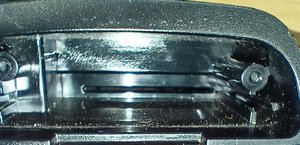

Where can I find the frame for a fugoo xl? The charging port is broken and doesn't look like it can be replaced by it's self.

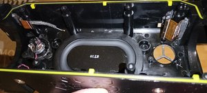

they glued a ribbon cable to the frame. cant be taken apart unfortunately, at least not without big modifications. anyone trying be careful the ribon cables are taped to the motherboard. And on the side where the the ribbon connects to the charging port and usb, the ribbon itself is glued to the frame theres not even a plug to remove once you remove the glue just the ribbon :/
I have the same problem. I took it apart, even cut away at the plastic to access it. now I need a port?
Same issue. was surprised to find the micro usb mb didn't have screws keeping it in place. note one of the external screws won't come out, so I had to use needle nose pliers to hold the socket to get the screw out.

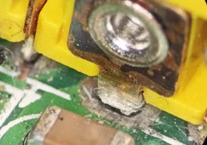

Carefully remove the silicone
Take out the PCB with the ribbon cable-no screews.
Joints are wery weak and had not enough soldering paste.
Resolder DC supply port(shame on you engineer of the soldering process design!)
Give some silicone on the ribbon cable and put it back to the case.
