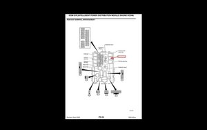

Where is the fuel pump relay at on 2003 altima 2.5.I don't know where it is located at.I have checked everywhere.I see that it says it is built into ipdm e/r. Where that
Where is located at on a 05 altima 3.5
Hi @rudyg ,
Here is a link to the 2003 Altima POWER SUPPLY, GROUND & CIRCUIT ELEMENTS, wiring Diagram — POWER — 5, bATTERY POWER SUPPLY — IGNITION SW, iGNITION POWER SUPPLY — IGNITION SW, sYSTEMS CONTROLLED BY IPDM E/R 14. section from the service manual. (click on the blue download button on the page).
On PG-24 you will find the a diagram showing the location of the relay in the IPDM E/R
Here is an image which shows the location of the fuel pump relay in a 2003 Altima 2.5L (which is controlled by the IPDM E/R).
Also check Fuse #32 (this is the fuse for the pump (I think, I may be wrong about this though)
(click on image to enlarge for better viewing)

Hi @ Jared Carlson
Here is a link to the 2005 Nissan Altima - Power Supply, Ground & Circuit Elements (Section PG) section of the service manual.
On PG-24 you will find the a diagram showing the relay location in the IPDM E/R
Here is an image which shows the location of the fuel pump relay.
(click om image to enlarge for better viewing)
Also check Fuse #50 (this is the fuse for the pump)
