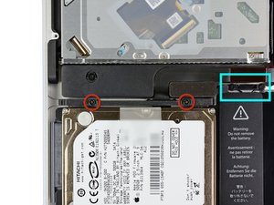

You also may want to replace the HD SATA cable as this series had issues with it. This is important if you've upgraded the drive to a SSD. Here is the IFIXIT guide you'll need to follow: MacBook Pro 15" Unibody Late 2011 Hard Drive/IR Sensor Cable Replacement and you'll want this newer version of the part: MacBook Pro 15" Unibody (Mid 2012) Hard Drive Cable - Apple P/N 923-0084. Yes! This is the part you want! The older part is not as well engineered.
Two more points you'll want to place some electrical tape on the upper case where the cable crosses as the cable tends to abrade against the rough aluminum. You also want to make sure the black plastic bottom cover clip as seen here marked in Blue is not damaged, if it is you'll need to move the other one over:
