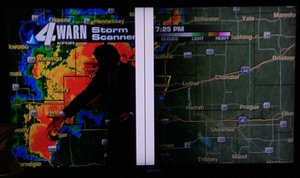

Sony Bravia Model No: KDL-47W805A
Only yesterday a number of horizontal lines appeared on my TV screen, only the lower 1/3 portion of the screen though. They intermittently flicker between 1/3 of the screen having visible lines to only the top three of four lines.
I have attached two pictures below which I hope go some way to demonstrating the issue.
So far I have:
1: Switched the TV off for a period of time and then switched it back on - The lines still appear.
2: Removed all the connecting cables (Amazon, HDMI, Cable) and then switched it back on again - The lines still appear.
3: Conducted a factory reset - The lines still appear.
4: Applied pressure along the edges of the TV where the lines appear - No change, the lines are still visible, no distortion to them. Although this might seem strange I read somewhere that if there is a loose connection along the LCD connectors applying pressure might confirm this is the lines change with the application of pressure.
5: Given up :(

This is usually a ribbon cable that leads from the LCD to the main video board that for whatever reason has unseated some of its contacts...if you feel brave enough and think it's worth reseating the cable...make sure it's switched off from the mains...put the tv face down on a duvet or bed...remove all the rear screws and spcables and prise of rear panel....look for the main cable that comes from the LCD and trace where it connected to the video board...disconnect one end at a time and check for oxidation on the contacts...and reseat....thus usually cures thus type of problem...if it doesn't then the next likely area of cause will be the video board itself....these are modular and you can either source the exact board from eBay or source a broken screen version if the same tv..and use it for donor..bits..or chance your arm and get a quote from a tv repairer or bite the bullet and by another set..I know some the answers are pretty obvious...but I am sure you will gain more of an idea from what's been said .

I recognize that this is an old question. Horizontal lines are almost exclusively caused by failed Gate drivers on the panel. They are part of the panel and can not easily replaced (requires special equipment). You can always check the small ribbon cables that connect from the driver board (part of the panel) to the LCD panel itself. Those flat ribbon cables are bonded to the panel. Push on the ribbon cable that corresponds to the location of the line. If that line changes or disappears it is a failed bond. Should the line be unchanged it is the actual gate driver for that region which has failed. this is not a board failure, but a panel issue.

I had fine horizontal lines and grainy screen with shadowing on my 55” LG LED TV. It was about 10 years old. Took t-con board and data board out of TV and preheated my oven to 210 degrees Celsius, baked them for 10 minutes exactly on a pizza tray. Put TV back together. Working like new again. Vic H.

I have a Samsung. The higher resolution output of the TV causes the lines, going to lower HD still gives an outstanding picture quality and got rid of the lines.

If you are using a stick to stream with of some sort I just spent some time trying to fix my lines and I went into the stick settings and it said "always play as HDR"
I turned that off and now streams are playing like they are meant to as some cartoons are made in 720 or 1080 and by forcing 4K it was trying to upscale something that wasn't there resulting in flaws in the picture and lines.
It will still play 4k streams if they were shot or encoded in 4k or made in 4K depends how you set it.
I've just turned mine off or you could also set it to 1080 at 60 frames per second or auto and I've gotten rid of the issue and everything looks incredible again.
