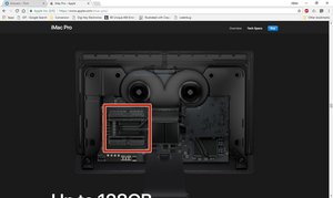

Can the RAM on these computers be upgraded?
The additional cost to get the 128gb of RAM on this system is astronomical. If I buy one with the default 32gb RAM, will I be able to crack this thing open down the road and install 3rd party RAM if I want to expand?

Yes, it can:
Standard RAM:32 GBMaximum RAM:128 GB*
Details:*Apple reports that this iMac Pro supports "up to 128 GB of quad-channel 2666 MHz DDR4 ECC memory." By default, it ships with four 8 GB memory modules. At the time of purchase, Apple also offers to configure this model with 64 GB or 128 GB of RAM for an extra US$800 or US$2400, respectively.
Here are the kits available from OWC to do a RAM upgrade:
https://eshop.macsales.com/upgrades/appl...
RAM may be upgraded, but it is not "user-accessible". You should firstly disassemble display to get access, and of course you lose your warranty

We'll need to wait for the IFIXIT teardown to understand more fully what is needed to replace or upgrade the RAM. I'm sure you have other questions on the SSD and general serviceability of this system. This system does not have an access door like the other 27" models.
Per Apple's notes: "The RAM can be serviced by a qualified Apple technician".
Now consider when you plan to add the RAM. Most people won't need more than 32 GB. Which gets into the systems warranty and if you void it by doing it your self, I would hold off until the warranty has expired. If you are doing this sooner, have Apple or Apples certified service techs do it so you don't loose coverage. Given the price of this system I would caution you doing this your self as it could be a very expensive Oops!
It would appear so. on apples site they show a glimpse of the inside.
@captainsnowball - Its serviceable not user accessible RAM
Its not easy to get to either as you need to fully remove the logic board. Review this: iMac Intel 21.5" Retina 4K Display (2017) RAM Replacement This is about the same procedure you'll likely need to do.

Yes, but take it a shop that’s done it before. 64GB of DDR4 RAM can be purchased here: https://eshop.macsales.com/item/OWC/DID2...
But the hard part is getting to the memory. Apple might have considered this when they designed the layout. It should cost you about $300-$350 in labor + $350 for 64GB of memory. Good luck!
