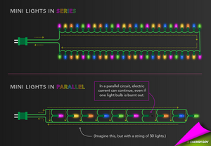

I believe that open circuits don't damage anything else. But, a burned out LED will likely be shorted increasing the current in the circuit. That would be the same as removing the socket from the circuit and soldering the resulting leads together.
Now...Current in a circuit is the same throughout the circuit. So...if you removed or had several LEDs burn out and short, than this circuit would have higher current flow...and if this string was the first in a daisy linked chain of strings...would this endanger the entire length of this chain?

Every socket that is bypassed or burned out will increase the current. Burned out LEDs become a short and not an open. The higher the current the more strain on the string and all the other LEDs, shortening their life. The snowball effect. Now does the fact that the string is split in half prevent this snowballing to the other strings? Or does the fuse prevent that?

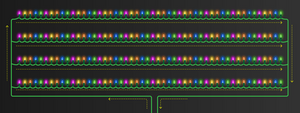

Lets say you have three colors and you have them in a linear order (Y - G - R) over and over again down the chain. So the string is wired so you could blink the different colors independently. Then you would have three intertwined strands and the plug would house the blink controller.

We have hundreds of strings and we had quite a few strings go bad on half the string. We are in Florida and we store the strings in large totes in a shed. From my research on this site: when LEDs burn out they short, they don't go open. So if half the string is out, then it would have to be due to an open circuit which would not stress the system. That being said then, these lights were operating when we put them away the previous year so it would seem that wires wouldn't break just laying in the totes so possibly the Florida humidity is corroding the connections. Any ideas on how to prevent that? Or repair that? We probably have 50 strings or more that are bad. If one LED is corroded going open, then how do you find it with LEDs not providing a continuous circuit. I have a string at home that runs 3 wires to every socket and you can remove an LED and the lights stay on, which leads me to believe that it is wired in parallel. Thanks to all the folks who have offered ideas.

The trouble that I invariably find is that moisture gets into the sleeving where the wires are soldered to the LED. Because the manufacturers of these LEDs are keeping costs to a minimum they use tin plated steel for the diode leads instead of copper. Inevitably the steel corrodes and when the lead has failed you have an open circuit. For a small number of failed diodes it is possible to remove them and solder new ones in, using heat shrink tubing to insulate and protect them. This is a tiresome process though if there are many that need replacing and where there are ten diodes not working (sets using a 31V supply have series strings of ten diodes that are all wired in parallel) it is not always apparent which diode(s) is(are) faulty. The fault I have described does not affect the rest of the lights and because it is an open circuit it just reduces the overall power so it is safe to continue using them if you don’t mind a number of them not working.
