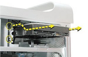

There are two hard drives in my power mac G5 but they won't come out the A drive I can pull out a little bit but gets stuck because there isn't enough room, and the B drive just won't budge a bit. I need to know which one to pull out first and how.
person this from the manual:
Procedure

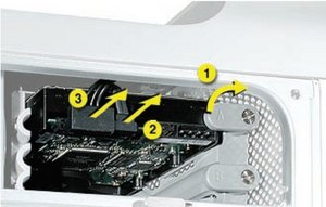

Release the drive locking latch by rotating it up.
Disconnect the drive data cable and power cable from the hard drive.
Pull the drive out of the drive bay, being careful not to touch the bottom of the drive.
Note: If you encounter resistance, use a flatblade screwdriver to release the latches on the drive bay rails as you pull the drive out of the bay. (See circled areas on the illustration below.) If two drives are installed, remove the bottom drive first.

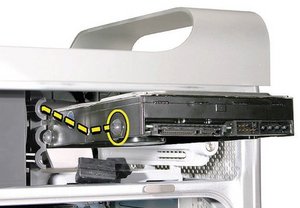

Replacement Note: If you are replacing a hard drive with a new drive, transfer the four guide screws from the sides of the original drive to the new drive. If you are installing an additional drive, transfer the guide screws from the side of the hard drive bay to the drive.
Replacement Note: When replacing the top drive, make sure the guide screws align with the middle slot of the drive bay, and then gently push the drive into the bay until it snaps into place.
When installing a bottom drive, align the guide screws with the bottom slot of the drive bay and slide the drive in until it snaps into place.
