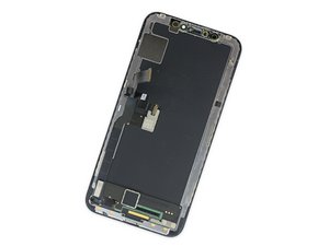

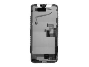

@captainsnowball - If you look at the X-Ray as well as the backside of the display unit there is no obvious hall sensor. It needs to be clear of any ferrous metals, the display's back plate appears to be steel. Even still the X-Ray view doesn't show any blip of a sensor. The cover has the magnet which grabs the steel of the back plate. See for your self:
If Apple is using a hall sensor they've hidden it quite well!
