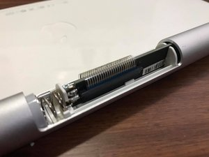

I just fixed a wireless keyboard with many non functioning keys. It had had a problem with leaking batteries, which I had cleaned up as best I could.
When the keys misbehaved, I opened up the little plastic hatch in the back to see if anything was obviously wrong. It all looked fine, so I pulled (very delicately!) the ribbon cable out of the place it connects to. I cleaned the cable, and squeezed a bit of rubbing alcohol into the connector. Let it sit for a bit, then blew it out with compressed air. Voila! most of the keys now worked. Repeated the process and now all of the keys work.
I can imagine that connection being the source of many key problems, even without the battery acid.

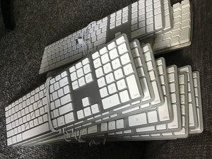

Update (04/08/2020)
I’ve got over a dozen wired aluminum Apple keyboards that don’t work.
Update (04/10/2020)
. Didn’t work on any of these. Let’s face it, there is no cure except give in to Apple and give them more money!

I have A1255 keyboard (wireless) and 80% of the keys (mostly letters) stopped working. I opened the gray back compartment and it turned out that the main ribbon holding thingy was in the wrong position (up). I slightly tucked the ribbon and put the holder in the down position.
I had previously disassembled the keyboard and must have missed some step putting it back. Or my cat dropped the keyboard from the table and dislodged the ribbon. Or likely both. Now it works.
Thanks @craiglapp2000 for pointing into the right direction with your comment.
