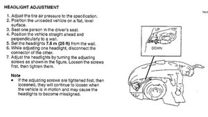

The low beam is set to high and blinds oncoming drivers at night. I am unable to locate any adjusting screws when the lights are up in position for night driving.
@bdjc from the service manual:
