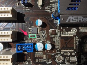

Hi Folks,
My friend has came across with his broken PC where I've found a burned out component on the Motherboard Asrock P67 pro3 , but wasn't able to read a top layer with model on it. Can someone give an advice which micro-component should I get for a replacement? Thank you :)

are you referring to this? based on the circuit F5, it is a fuse
normally fuse blow can be due to surge or faulty ICs / transistor that draws alot of power and yea....
else the arrow you pointed could be a smd capacitor,
you need to get schematics to know the actual value of the components.

Hi Augustine,
Eventually I ordered a wrong fuse. So I decided to solder a tiny wire between two pins and finaly the motherboared has became alive :)
